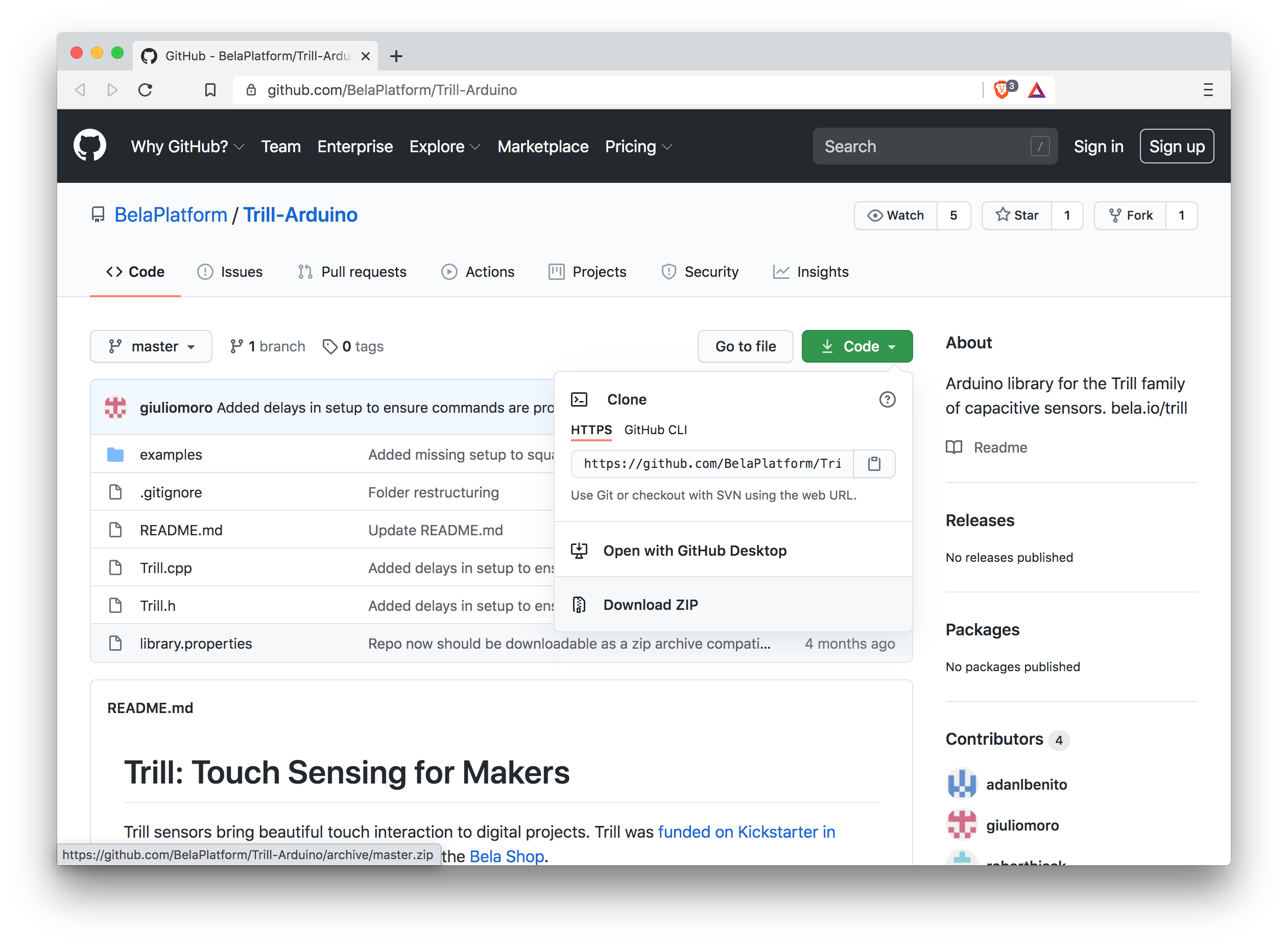

Download the Arduino Trill library from the Trill-Arduino Github repo.
To install the Trill library using the Arduino IDE, download it by clicking on Clone or download -> Download ZIP
and then follow the instructions provided by Arduino.

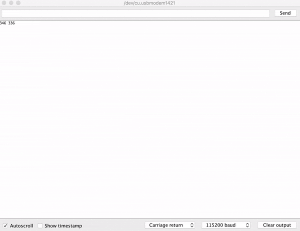

If you run this example you'll see that for every touch on the sensor a new pair of readings are printed to the serial monitor, as can be seen above. Each pair of values consists of the position on the sensor followed by the touch size. The position value returned will be an int which depends on the number of pads along each axis of the sensor according to the following equation: 128 * (numPads -1)
(see below table).

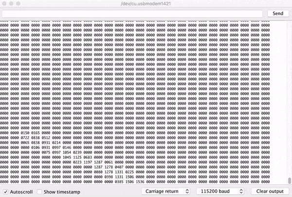

A good sketch to run to see the raw readings is raw-multi-print which, once uploaded to the board, will print the raw values of any sensor connected to the Arduino to the serial monitor. If you do so you will see something like below where every individual pad on the sensor has a reading:

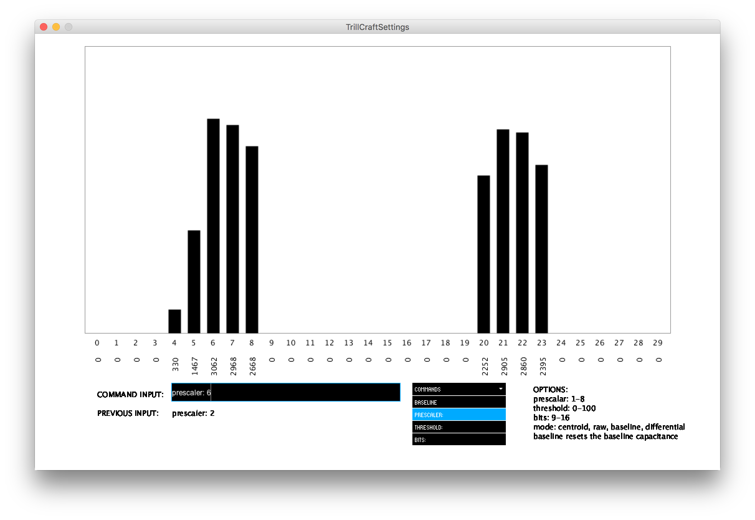

There is also a handy Processing counterpart for this example called TrillCraftSettings
which you will find as part of Processing library as discussed above. When you run this processing sketch alongside the craft-settings
Arduino example you will see a bar graph with the raw readings from each of the 30 channels of Trill Craft.
In order to use this Processing sketch you will need to install the controlP5
library which you can do in Processing via Sketch > Import Library... > Add Library...
You can interactively change the settings and see the effect on the readings. Select the setting you would like to change from the dropdown menu which will auto-populate the console window, add the value that your would like to change in the console (check the comment in the example for the expected values for each setting), and hit enter to apply that setting. You will now see effect of that setting on the readings in the bar graph.
